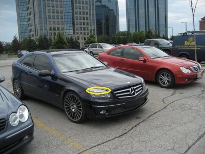

I have a 2009 CLC. I have noticed that the previous owner has changed one sidelight bulb so now one is more of a 'yellow' colour to the other. I want to change both so they are matching, what is the most brightest 'white' appearing bulb I could put in please? Thanks.IMG_0322.jpg

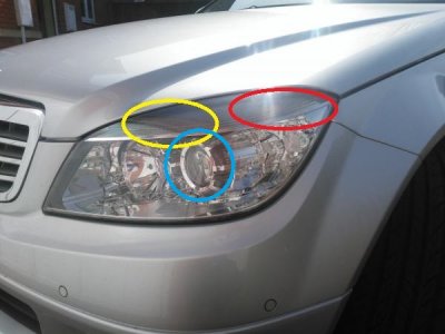

These are what I put in at your recommendation so i need matching onse to go where the red circle is.
Now I have successfully changed the sidelight and parking lights bulbs to these, now the headlights appear yellow. Could you recommend brighter bulbs to go with the others please. Thanks.

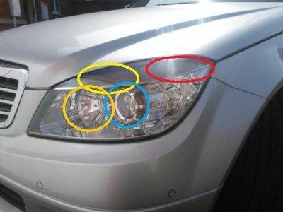

In blue is what I need to change now, whilst Im at it I may as well change the ones in orange?9876-1462527979-497e3b0b2724280672bec62dd83ddf3a.jpg

Osram Nightbreaker Ultimate or Lazer - I have Ultimates in dips (on full time) and Lazers in mains, not convinced the Lazers are worth the extra money compared to Ultimates.
