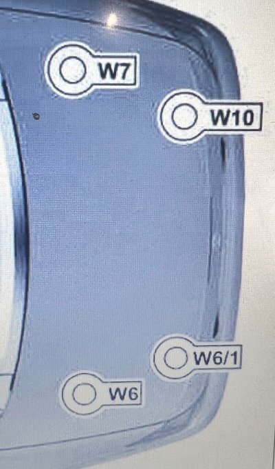

Where do the R230 rear lights earth please??
Update I have had it on a STAR diagnostic computer and there are no fault codes reported as such but when asked it does say that there are bulbs out in the tail light clusters.
The guy I use is very bright and after mucking around with his computer he thinks its an earth problem - maybe specific to the LED strip.
Somewhere very near the light cluster. Pull the carpet out and have a look. I can find it for you but need a chassis number.

W points are grounds.

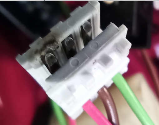

I think I may have found the issue - I unplugged the connector to the LED circuit board and found this:
I that burning damage do you think or corrosion?
There are no failed components on the individual boards.
Is this the problem do you think ?
Is it possible to buy the circuit boards on their own ?
