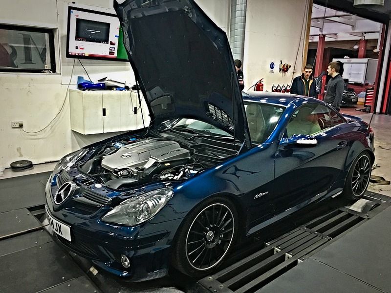

So yesterday I took the car to Birmingham to see Acid for a EUROCHARGED dyno map by Jerry.
As some of you know the car was already remapped by west-tuning before I fitted the kleemann headers & down pipes.
We ran it on the MSL dyno as soon as I got in and the car pushed 324WHP and 393ift TQ.
So Acid did his thing, took the ECU out, extracted everything and sent it over to Jerry to modify and map the car with the kleemann mods.. A few hours later the car is back on the dyno and the results after the Eurocharged remap is better.
At the wheels it pushed 336WHP & 407ibft TQ
I'm very pleased with results and the Eurocharged remap, it's now FAST & LOUD. :D

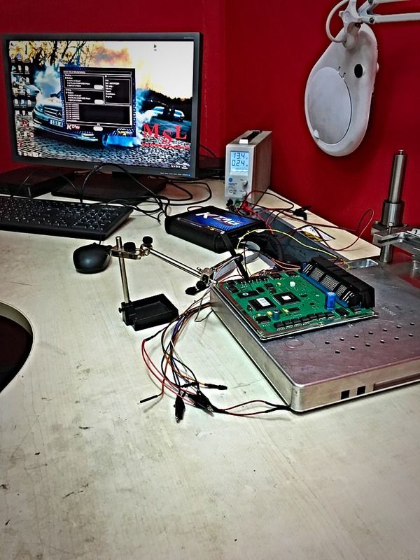

Here's the ECU out, getting mapped, had a bit of a scare..
When we tried to map the car via the OBD port the car didn't start, so Acid took the ECU out, extracted the files and sent it over to Jerry.
I'm not going to lie, I was slightly worried however Acid wasn't at all, in fact he was laughing.. Lol. :D
