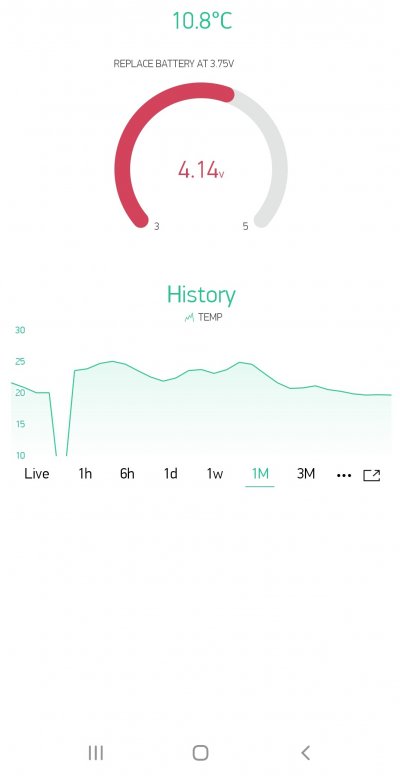

I wanted one for monitoring water temperature but they are ridiculous money so I built one.
It runs off 3AA batteries so I also send battery voltage - simple to build and code using Arduino.
Updates every hour over WiFi to an application on my phone.
The app is free, it's called Blynk, look it up..
