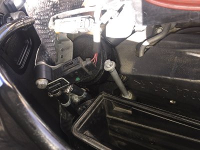

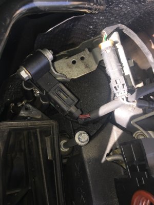

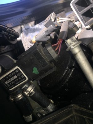

I think these two issues may be unrelated - but this morning when I started the car, I got a warning saying that my coolant is low... it wouldn't come back when i turned it off/on again but anyway... odd.. I bought some MB coolant and topped up a little.
On the drive this morning I also noticed that the car was smoking/steaming a little, from the engine bay. The 'smoke' seemed to be coming out of the passenger side front, but it varied a little. Temp is normal/stable.
When I got home, on investigation, the smoke seems to be coming from near the pressure control valve, behind the air filter on the driver's side. I shot a short video, attached. It's near the breather valve that connects to the turbo intake pipe.
I've also attached some pictures showing an oily/wet area.
As I was disassembling things, the whole air intake unit just slipped off and I realised that the big red/orange turbo seal was shot and so I went to MB and purchased new one, along with a few other seals, pictured. I replaced them but it didn't make the smoke go away when the car is running.
Can anyone suggest the source of the problem/smoke?
The pipe from the turbo intake to the oil separator could be leaking, I suppose, but it's £15 and special delivery from germany, would be here in a few days. The MB parts guy seemed to suggest that's rare the problem. It's also possible that it's the oil separator itself?
I'm guessing if there's a coolant leak, it's unrelated/coincidence, as there isn't really any cooling hoses back there?
Thanks for any info you could give!
