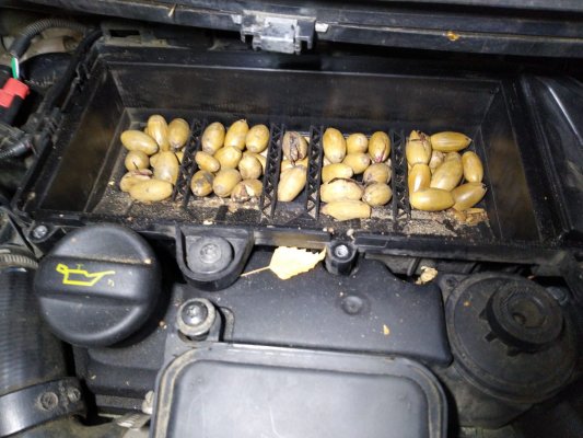

Nov 24, 2020 #1 MissyD MB Enthusiast SUPPORTER Joined Jan 28, 2010 Messages 8,925 Location Essex Car E200 1993, E300 Coupe 2019 A friend had a car in today that the lady said wasn't running very well. It was a diesel running lumpy and clouds of black smoke! Acorns had totally filled up the air intake pipe from the front of the car round to the air filter box. These were all the acorns taken from the car

Nov 24, 2020 #2 T Teego MB Enthusiast Joined Feb 2, 2018 Messages 2,225 Location Derbyshire Car CLS55 AMG Squirrels are going to be bloody annoyed when they find out. They'll no doubt be out for revenge on her wiring.

Nov 24, 2020 #3 OP OP MissyD MB Enthusiast SUPPORTER Joined Jan 28, 2010 Messages 8,925 Location Essex Car E200 1993, E300 Coupe 2019 Teego said: Squirrels are going to be bloody annoyed when they find out. They'll no doubt be out for revenge on her wiring. Click to expand... That will be next weeks job
