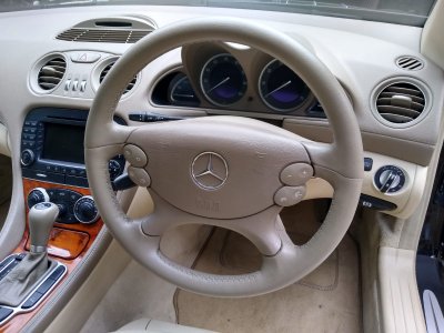

OK I have solved this. The steering wheel and upper trim colour on an R230 with the beige 205A seat upholstery which is actually cream and is I think also called Pebble is a mercedes colour called "Stone"
I purchased some steering wheel colouring dye in Mercedes "Stone" from a company called Colourlock whose product I had used before on a few worn bits of my CLS63 wheel in Kashmere Beige.
The "stone" match was absolutely perfect. Its very easy to use ; 1) clean the wheel with the special cleaner then 2) dab the colour on lightly with the sponge supplied doing coat after coat ,drying each one with a hair dryer (this both dries and removes any bubbles left by the sponge) before applying the next. My SL wheel was literally bald accross 80% of the top half (wifes rings over 7 years I think) so I was a bit sceptical it would cover the dark bare leather,
Anyway after about ten coats which took about 30 mins the result is a wheel that looks like new. My experience with the cls55 (63 wheel) is that after 3 years it has barely worn at all so pretty tough. The finish is that nice new matt leather look . looks and feels great. take a look and remember it was completely bald on the top half of the wheel. Unfortunately I didnt take a before which I now wish I had. Anyway problem solved and wheel refinished.

Oh forgot to say that I masked the leather from the plastic airbag, boss and sterring wheel buttons so there was no "overdab"!!
