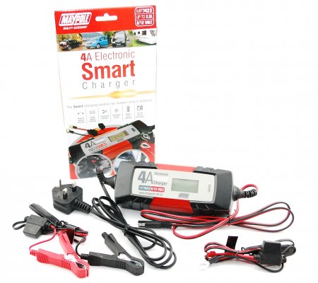

If you have access to a trickle-charger (e.g. CTEK), then you can try charging the battery overnight and see what happens.
+1 for this. It’s that time of year again.
i’d simply say that the battery may well need a top up charge. Borrowing someone’s charger to “fill ‘er up” could well solve the problem. Even if it doesn’t, it’ll extend your battery life

Definitely get yourself a CTEK charger. My wifes A200 stop/start wasn't working, the car was driven 120 miles to Dublin airport(stop start still didn't work)), left for a week and driven 120 miles back home, still no stop/start.
Threw it on charge for about 24 hours, and stop/start was working again within a couple of hundred metred from leaving the house.

Similar story. My partner's A160 stop/start didn't function at all for about a year. I checked both batteries at the time and they seemed OK on a basic voltage check, so I decided not to bother throwing money at new batteries without being sure of the cause. During the first lockdown this year the main battery went flat after a few weeks sitting idle so I charged it up using my CTEK charger, and used the "recondition" mode because the battery was 9 years old at this point, and stop/start has worked ever since.
