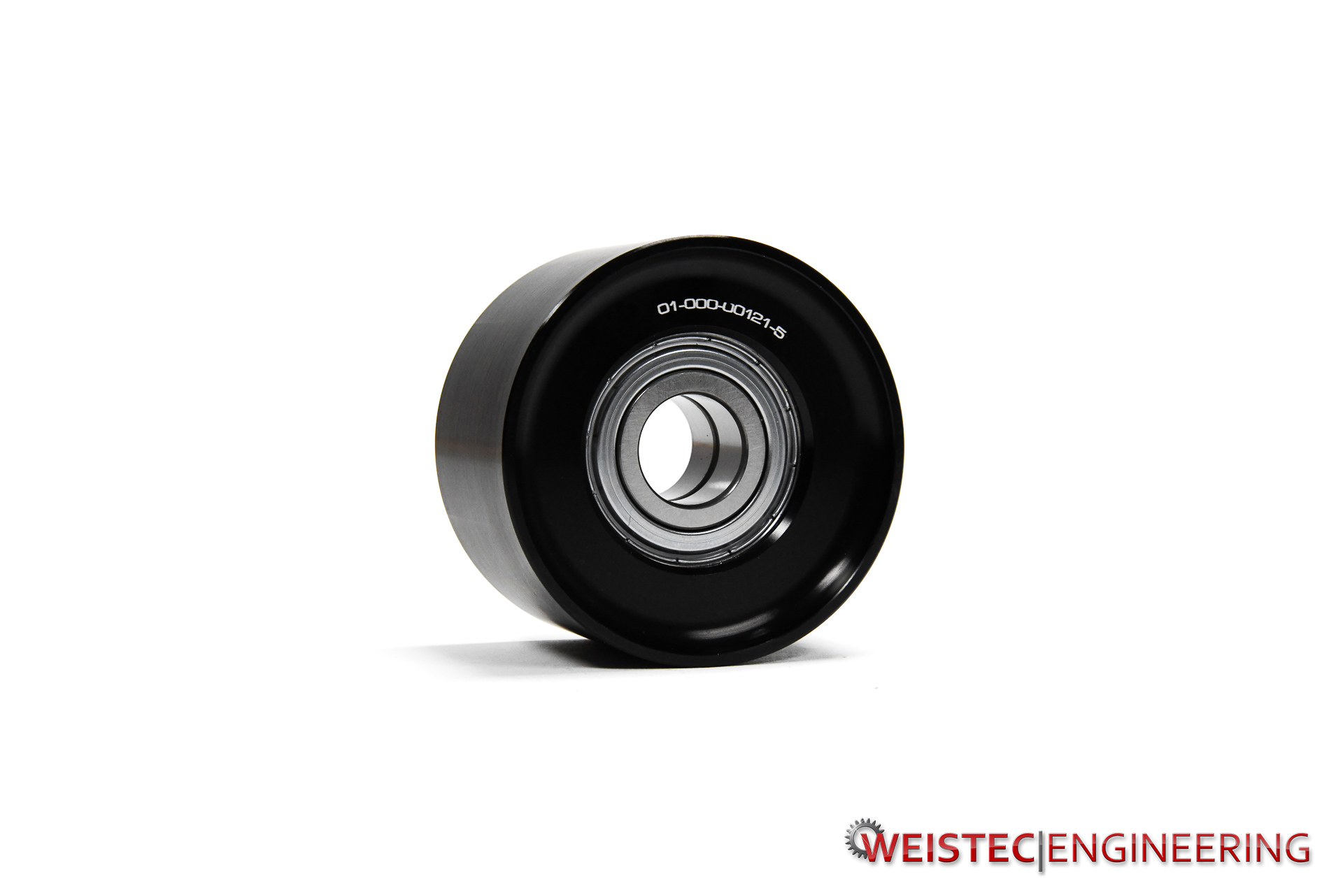

not familiar with the PTG kit but have stage 2 Weistec on mine, the supercharger itself I've had no issues but the pulleys they come with (or at least did when I bought) are prone to failure, they are sold as an upgrade (also available separately) but the bearings they use are not as good as OEM, they just upgraded the outer pulley material
Yes I did read about this on the other forum as well, people faced premature pulley wear and they had to change it on regular basis…

Despite them bundling the billet pulleys with the supercharger when you buy one, if you look to buy them separately, Weistecs own website says they are not suitable for supercharged applications. That should tell anyone all they need to know. Its a joke tbh.
Not a big Facebook user, but having had this issue myself I ended up finding this post on the C63 AMG UK owners group, where seemingly the majority of people who have gone Weistec have had this failure
Again, tells you all you need to know. Weistec know about the issue, but they wont do anything about it to support customers who have been left stranded due to pulley/belt failure (other than add the caveat to their product page - which is missing if you check the product pages for the individual pulleys rather than a kit) and continue to sell them. And of course, when a pulley fails and ruins your belt, you are left waiting for a new supercharger specific belt to be shipped from the US, which is not quick
I asked the above question as I wondered if it was a Weistec crank pulley rather than the idlers, as I have seen that upgrade but mine doesnt have it - which I'm quite glad about both based on the above but also I dont think it has the marking to set the engine to 40 degrees from TDC to allow safe work on the engine
