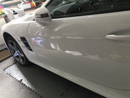

I've been meaning to try Turtle Wax ceramic spray, either that or the Autoglym version (since I have some Halfords vouchers and they don't stock the TW version). That's a cracking reflection on your car, especially considering that it's white. :cool:
