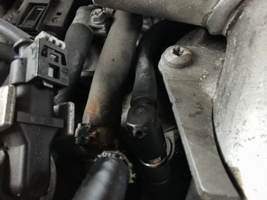

Last week I bought my first MB (Had BMWs all my life), and sorting out a couple of issues. Already replaced the battery, oil filter/cabin filter/ oil/ cabin filter. Next job is a garage for transmission service.
Anyway, engine temp was very erratic, sometimes would go up but would often sit at 40, so I'm thinking thermostat. I order one in and start the job. Hit two snags.
Firstly (most importantly), I've managed to snap a plastic hose connector (see pic below). Its a T hose that is part of the coolant system. Its no ordinary connector, has no jubilee clip or anything. It seems to be just a push fit..... but the hardest push fit on the planet. no amount of pliers or anything can seem to get this small hose of the T connector. Does anyone know a way around this? My only thoughts are a new connector, then cut each of the hoses down by 10mm and fix it on again, perhaps with a jubilee. On that, I've no idea what the T connector is called, is there a source for exploded diagrams of engines so I can call MB up and order?
Secondly, the current thermostat has a electrical connector. The new housing has space for the connector, but no connector. Would anyone know if you can just swap the thermostat its self, and use the old housing?
Many thanks in advance!
Andrew
(ps -if anyone lives around Farnham / Guildford way and can recommend a good Indy then I'm all ears.)
