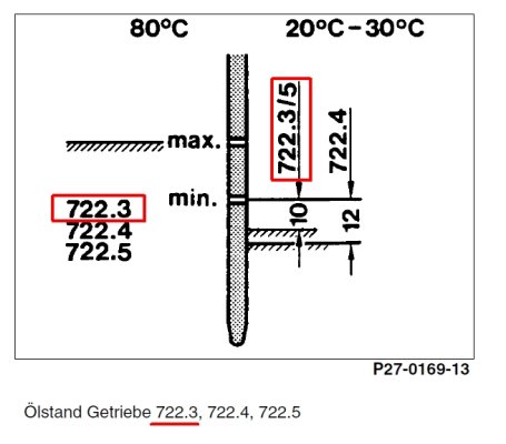

Just make sure to check the ATF the right way .Engine fully warm and selector in P brake on .Then pull the stick out and check it =Ölstand1.jpg.

Just make sure to check the ATF the right way .Engine fully warm and selector in P brake on .Then pull the stick out and check it = View attachment 128148.
I checked the level many times and after a long drive, with the engine running and the transmission in park, the level is right between the min and max marks at 80°C.
