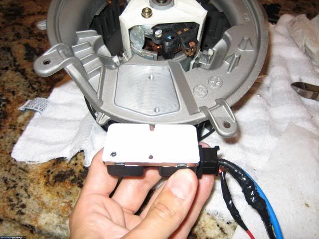

Took my heater motor out today.(pics)
PaulE230
Mar 27, 2007
617
took a few photos with my phone
Anyone know where the regulator is ?
I was suprised to see bmw on the connection block lol
Looks very big are you planning to replace that with a new one ?
I had a problem with that exact unit earlier this year, the regulator is the black bit but you will not find one by itself, it was a bad design and now you have to buy the regulator and fan all in one... not cheap..

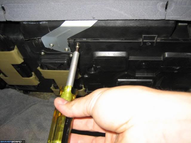

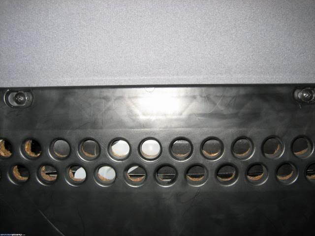

First of all lets see where the part is located. Look under the passenger side footwell and look up. This is what you will see:
Remove two phillips head screws and the cover can be pulled off toward the seat. With that cover off you will see the blower motor cover:

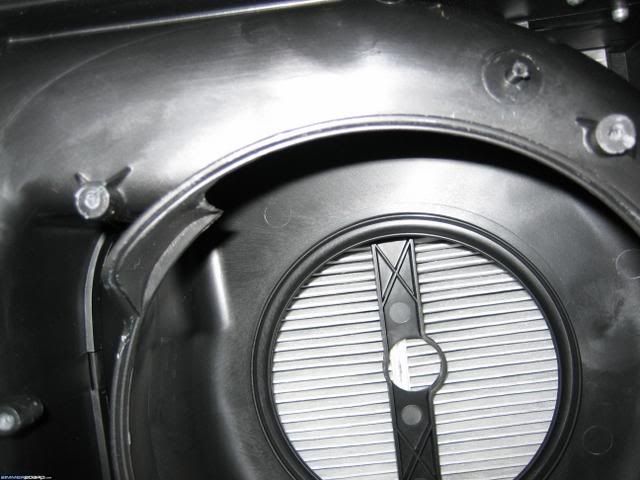

Remove the five Torx screws(T-20 i believe) and you will expose the blower motor and harness near the corner to your right nearest you:

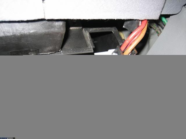

Disconnect the harness by pulling apart. There was no locking mechanism that I could find. After releasing the harness, remove four torx screws(Same size as the cover) and the blower assembly will drop down. If you look up the void left by dropping the blower you will see your A/C filters. Check their condition and replace them if they look dirty at all. I had replaced mine recently and they still looked new:

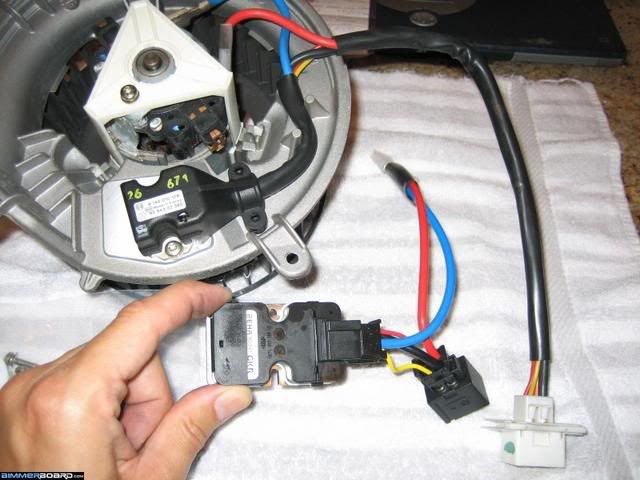

Take you blower assembly to your work table and you will see the blower motor regulator attached to the blower motor with two torx screws of the same size as all the others you removed earlier. Here is a picture of the old and new regulators. I purchased mine from http://www.autohausaz.com/

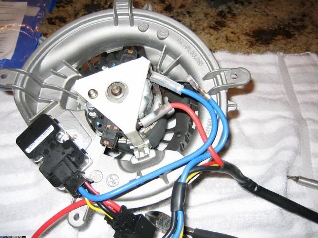

Remove the two torx screws and cut your OLD harness right next to the OLD regulator. You will be cutting four wires: a thick black one, a thick blue one, and two thinner yellow and red ones:
I stripped most of the black sheath covering the three wires on the OLD harness to give myself room to strip the insulation off of the three wires I will need to splice.

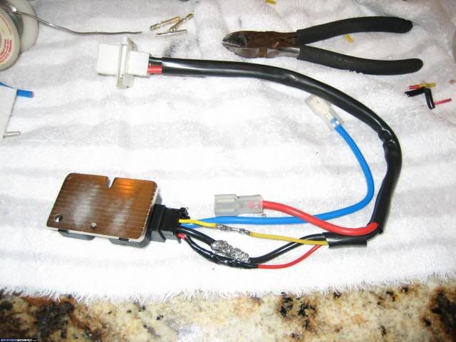

Next take your new harness and regulator. You can go ahead and connect the blue wire with the spade connector to the blower motor. You will need to remove the blue wire coming from the OLD harness from the motor to do this. Throw the old blue wire away. The OLD red wire attached to the blower motor will stay. This is what it will look like:
Now cut the four wires going into the NEW harness connector(Cut the wires as far away from the new regulator as possible). Note that the blue one goes straight to the blower motor so it will not be cut. You will need to cut right next to the connector box in order to leave enough wire to splice to the OLD harness. When you cut the four wires, you can discard the thick red wire. The other three wires will be spliced to the three wires (black,yellow and red) from the OLD harness. Here's how i spliced and soddered mine:
I then taped each wire with electrical tape, put a very thin coat of the included dielectric grease to the new regulator, and mounted the new regulator with the two new torx screws supplied with the new harness:
