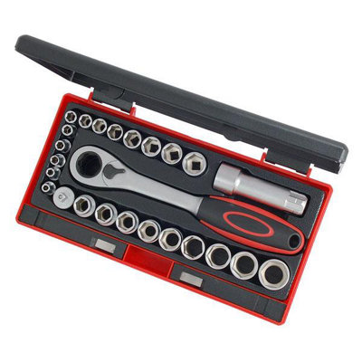

You mean like this ?

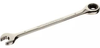

Yes, we got crow feet w1ghty, & a few ratchet spanners petrol Pete.
The 1' we have are to heavy thick metal & can obstruct the amount of space to put them in. The spanners are good, but again didn't give me enough leverage (bolt is tight), got it in the end.

Aliexpress
Something like this
AP03 18Pcs Steering Hub Suspension Shock Absorber Strut Nut Removal Tool Socket Set for VW Ford Honda/Nissan etc. - AliExpress
They are generally listed as suspension or hub socket sets. And if you scroll down and look at the similar items at the bottom, I often find these are a better way of seeing what sort of thing is available, rather than searching directly which can be less reliable than looking at 'similar items' for some reason.
Look for one with the correct sizes you need, both with the socket and the torx pieces. The ratchet provided goes around the outside of the sockets provided, and you use a separate square ratchet that you own to drive the torx bits.

Halfords , I'm fairly sure , do a socket set which allows rod to be passed through .
Just looked ; I'm sure they previously did one of their own brand 'Advanced' pass through socket sets , but the one pass through set they now offer does not have an 18mm socket in it !
They do offer a singular 18mm ratchet spanner , at an impressive price !
Or they do a set of ratchet spanners , similar to the ones I have , although my older set does not include 18mm , but the one below does .
