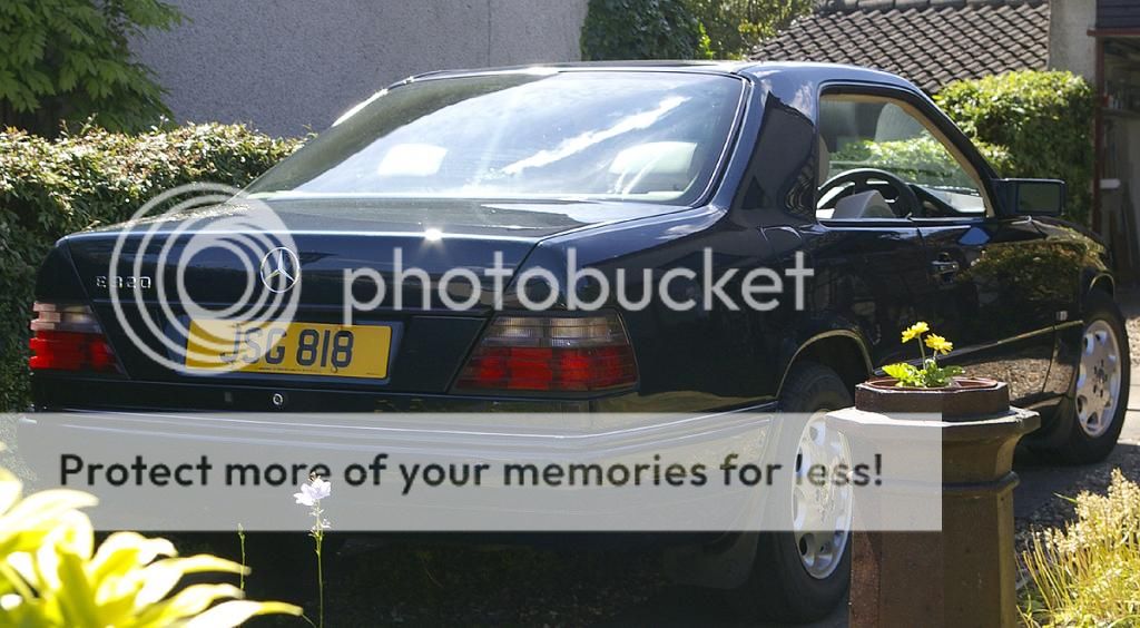

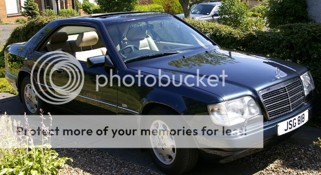

A couple of gratuitous shots as it's a lovey day and she's lookin' good. (washed a coupe of days ago)
_IGP5987.jpg~original
_IGP5988.jpg~original
That looks beautiful - but check that the
wiring loom and the wiring in the ETA have been replaced, and that it has had a new head gasket at some stage: in each case the replacements should last, even if done some time ago, but you could be looking at £3000 for those items if they haven't yet been done. Otherwise it's mostly about rust, rust, and rust. The slam panel under the bonnet is a good tell-tale for this - if it's rough and all else is good, then probably rust repairs have been done - which is better than not being done, but not as good as the ( ultra-rare ) alternative of not having been rusty.
Tell me about it...:eek:
...wouldn't have it any other way.
