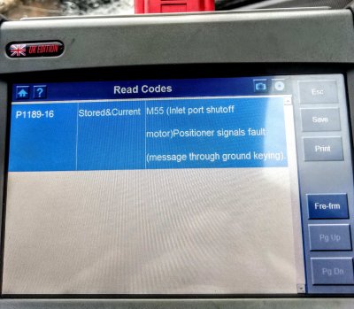

Bought a 2001 w210 e320cdi that had pretty much been sat in a garage for 6 years after an Mot fail.
I've fixed, replaced and repaired pretty much everything and she just sailed through her test!
The only thing still giving me grief is the box!
No kick down, no manual selection of gears and wouldn't rev past 2000 rpm. I assume limp mode. So I dropped the trans fluid and the filter. Plug the car in and cleared loads of stored and pending codes. Most of which stemmed from it being dead for so long.
It now changes in manual but doesn't change in auto and doesn't kick down at all?
I also have a feeling it might be a bit overfilled as I'm not sure whats classed as the bottom for the dipstick!
Waiting to get the diagnostic machine back too.
Any help greatly appreciated.
