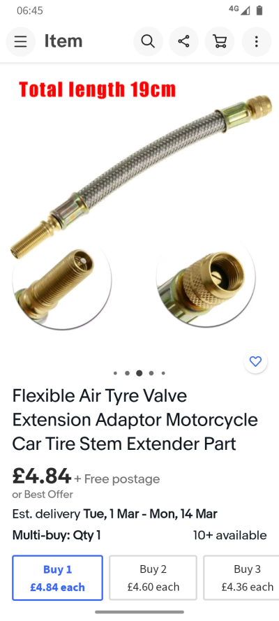

Mystery solved and so I have placed an order for a Ring RAC900 air compressor on Amazon.
I have also bought a flexible tyre valve extension. This last item cost me 10 quid and should be enough to solve the problem but since my 240D mostly "hibernates" during the winter months it's good to have an air compressor at hand to keep the tyres tip top without going out on the road.

Any of you gents needing a bit extra length on your bits , try using one of these ,just till youve inserted your psi.The wife will love it.
