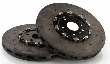

Can I just ask, are you running standard oem discs and pads at the front? I’ve just put a post out on brake section on here asking people opinions on what brakes I should get I’m not a fan of oem ones.
I'm surprised you find the OEM discs and pads unsatisfactory on your E63. Coming from an E55 with SBC braking I have found the OEM pads and discs more than adequate on my 2014 saloon. Saying this, I haven't had to pull down quickly from much over 130 (on a private road of course;)) so I understand if you are tracking or doing autobahn runs at high speed you may feel different.
Have you tried EBC Redstuff ceramic pads? I wrote to EBC here in Northampton as there aren't any pads listed on their website for the fronts of a W/S 212 in the UK yet US owners can buy them easily. I was given this Part# for front EBC Red ceramic pads if you want to explore that option.
I went OEM all around. I had them fitted in Dec but the car has only done a few miles since, as has been in storage. The difference between what the brake feel was like on the worn discs / pads v the new ones took me by surprise, as the new ones are so much better, sharper and instant. The discs and pads I took off could have lasted longer, but it just goes to show how you get use to them, I actually thought they were good before putting the new ones on.
If you visit the US MBWorld forum then there are lots of threads on there. There are no obvious alternatives that give noticeably better performance, but the main goal seems to be finding and using more cost effective alternatives.
OEM discs and pads are fine on my CLS55. Was in Germany last summer with 10000 miles on new front brakes. Hauled a bit sharpish down from 170 with total confidence. Of course, it has 8 pot calipers.
Similar experience with my pre-facelift bi-turbo E63 PPP. Almost flat out on the a-bahn and hit the anchors hard. 180-ish mph to much less with no drama, and no fade.
Both e63 I’ve had the discs have been in different condition and have/had brake fade. I didn’t put any on the last one as the car had less than 20k on and they weren’t worn much at all. This car the discs are in much poorer condition so I’m just trying to hear people’s opinion on both oem and aftermarket brakes, as with not having both cars with new oem brakes yet I can’t really comment on the true capabilities of a oem braking system properly bedded in.
I would prefer to go for a 2 piece disc with racing pad anyway, thanks a lot for that link I’m going to look into it more but I think I’m going to get brembo 2 piece discs and ebc red pads then. Thanks!
Yeah I’ve had a few people say to me now the brembo 2 piece discs is a good option I think I’m going to go with that one but will go on mbworld and have a read up also thanks.
Some more options mentioned before
Thanks, I tried first link on the page and it didn’t work, the other ones are oem discs and pads which I have covered.
ive went for brembo 2 piece discs and ebc red stuff pads.
Ordering braided hoses all round and Motul 660 brake fluid also
there are some iron two part discs cheaper
