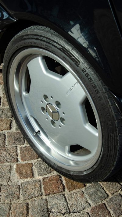

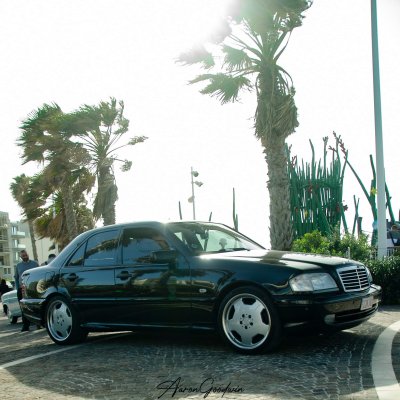

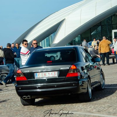

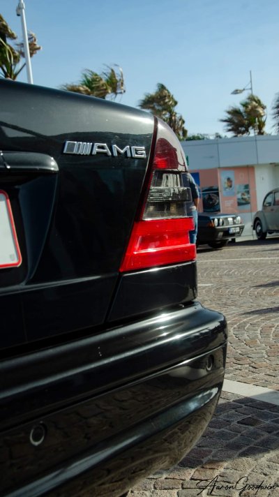

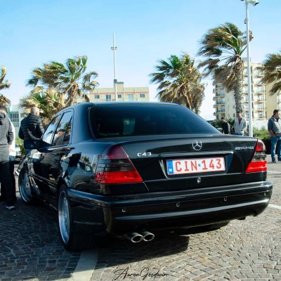

Here are some picture of it last Saturday at a car meet in Bugibba, Malta

Your boot panel gaps.
Passengers side show very tight panel gap where the drivers side has a wider panel gap.
Did your boot hinge snap on one side why it's tight on passengers side and wider on drivers side?
Bracket snaps and boot spring will come off from massive stress (opening and closing boot), the boot could fall down on your head injuring you!!
Be careful with this when you open the boot.
This is a problem on W202 with broken boot brackets.
MB made repair bolt kits.

The boot springs which open the trunk did snap but other than that I think it just needs a setting at the hinges. I've never heard of the actual hinges snapping, does it happen often?

If you take a flashlight and look through the insulation in boot where the boot arm goes inside the lining, you will see there is brackets sticking out on both sides of boot arms.
These brackets has pre-drilled holes where you attach boot springs and adjust tension for boot to fully open or not?
The bracket weith pre-drilled holes will snap !!
First only one side of the brackets snaps and spring will come off with a bang.
It will take some time when the other bracket snaps and then you have a psychotic boot clipping your neck if you are not careful and the boot could drop and severly injure you??
If it's windy and heavily blow outside you should be cautious if wind drops the boot on your neck.
Always hold one hand on the boot for safety if you put cargo in the car with your other hand.
Mine snapped with three years apart from first bracket to second bracket.
I bought repair kit from MB which puts the broken parts right back to it's original place with repair bolts and larger sized washers.
The W202 design from factory was very poor, Audi had better and more modern design on their MY1999 cars.

Repair kit for broken boot LEFT - RIGHT side brackets is A202 758 0214
New boot springs:
A202 757 0029 without boot spoiler
A202 757 0129 for boot spoiler ????
You need to check before ordering new springs which ones fits your car?
