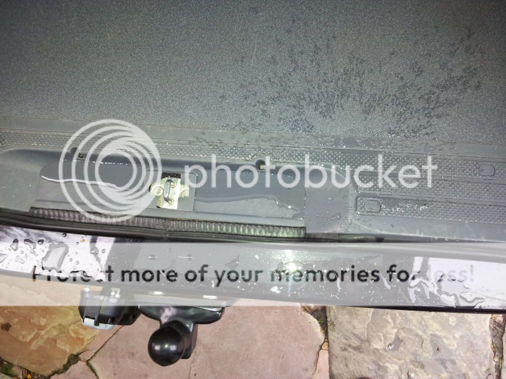

My 2008 Vito has developed a puzzling leak at the tailgate area.
The leak manifests itself only when the van has been stood in the rain.
If I hose or pressure-wash the van, there's not even a trace of water in the area. Driving in the rain won't bring about the great flood either. :confused:
Tailgate floor area.
Tailgate. The water is only ever seen on the O/S of the tailgate.
I'm 99% certain that the water is not coming from the tailgate itself. I'm sure the tailgate becomes wet by being close to the puddle.
Apart from railing off the area and buying some buoyancy aids, does anyone have any useful suggestions? :rolleyes:

No, nothing untoward has happened. I'm baffled by this.
It looks like the water drips down from the top and splashes up. Is the top seal ok and the wiring trunking?

Checked the top seal (goes all the way around the opening) and the wiring trunking today and all is well.

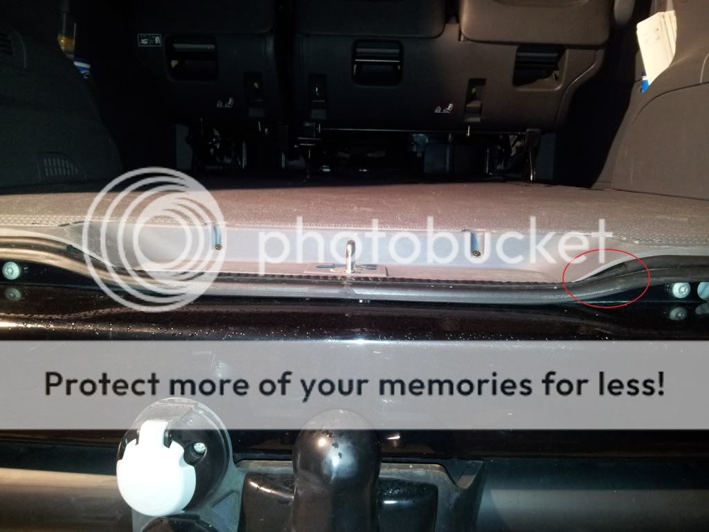

Just been out for another look (been raining, but not heavy) and took the picture below.
At first I noticed the lower trim on the RH side is 2mm lower, but when I uploaded the image I noticed a gap between the seal and the trim.
Hopefully this will explain the water getting underneath the trim and pooling.

From your first pictures I would say that the point of contact for the water is the raised section of the plastic trim, which means the water has to drip down from above, but inside the tailgate.
As a result, I doubt the rubber seal is the issue.

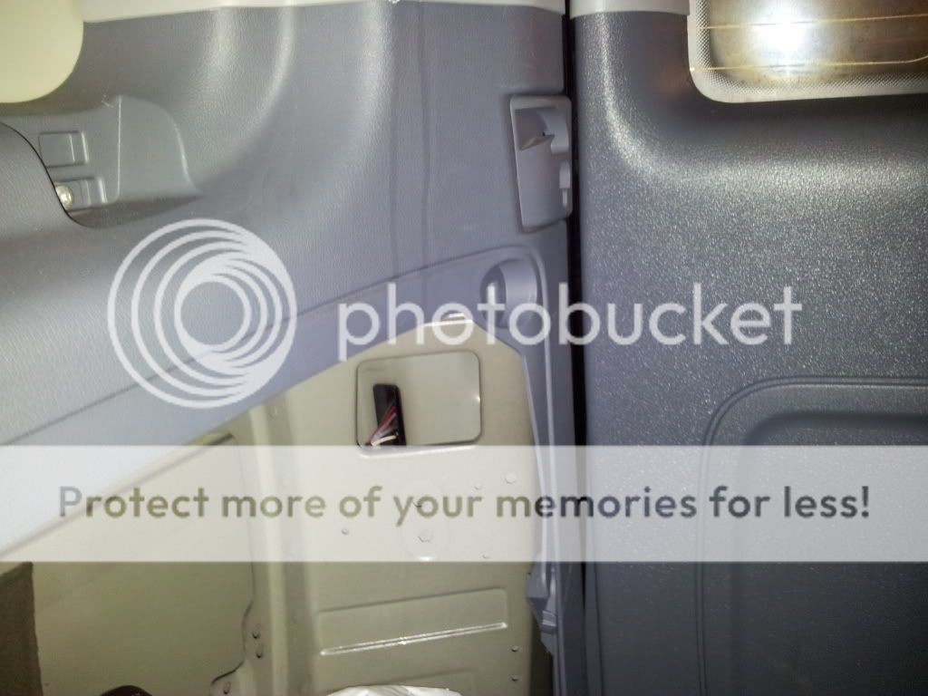

Next time the water pools I'll take the trim off the tailgate and see if there's any trace of moisture in there, but I haven't noticed any moisture under the tailgate trim to date.
I have had the trim off the tailgate several times to repair the leaking rear washer pipe which is now definitely fixed. If that was the source of the water I'd be able to smell the screenwash. Mercedes know about the leaking rear washer pipe problem but have produced a repair kit specifically for it. They have the audacity to charge victims £65 + Vat for the kit. Needles to say I didn't buy the kit. :rolleyes:

Just as an aside ... there's a known issue with a connector in the rear washer pipe pushing apart in very cold weather. it's an easy fix ... behind the interior trim panel by the offside rear light cluster. Just put small cable ties round to keep it together (dealer did it on mine).
You'll know if this has come apart as you'll get screenwash puddles ;)

There are some parallels to my problem here, by the look of it. Ringway - is the splash pattern in the first two photos exactly as you find the problem, or it that as a result of opening the tailgate?
To get a pattern like that, the water would have to be dropping from some height, i.e. not running down the tailgate to the floor.

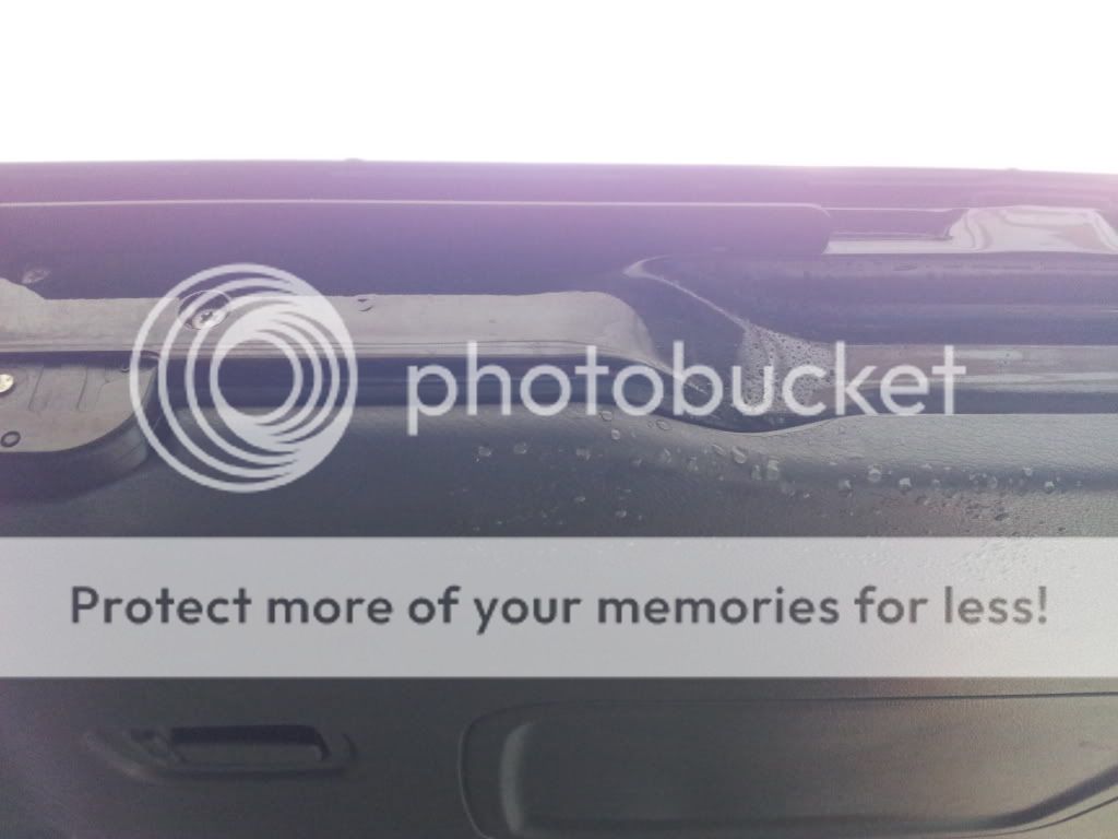

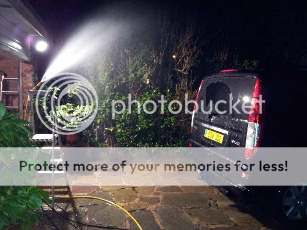

Okay, in an effort to unearth the source of the leak, I embarked upon a midnight experiment.
I left the hosepipe running for half an hour and got into the back of the van awaiting the great flood.
It took fully 15, minutes before I saw this.
And consequently this.
It is now obvious that the water is coming from the top of the tailgate, but the entry point is still unknown, for now.
Nicks (and Zenmans) call of the top rear brake light is a likely suspect. Before hosing, I did check the three screws that hold the brake cluster in place and they were tight enough, but that doesn't mean that the leak doesn't emanate from there. Further investigation is needed.
At the end of the hosing, there was evidence of water at the rear O/S panel, but after being subjected to such a downpour I'll let this issue pass.
