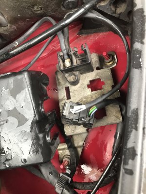

Hi all,
I am new to this forum and I understand the wiring loom issue has been addressed before, but I cannot find any answers to my perplexing situation.
I have a 94 E280 Estate that went in for other repairs almost a month ago when they discovered the degrading wiring loom. I knew this was a common issue and that Mercedes supply new looms, so we ordered a new wiring loom from Sandown Mercedes and it was fitted promptly. They told us they had already sold 14 this year! However, it was discovered that the wiring loom supplied had 3 extra connector plugs that sit near the cam cover and VVT area. We contacted Mercedes, who said that the wiring loom supplied is the only part they have for our engine and that they are unsure why there are 3 extra connectors attached, and whether they affected the operation of the engine. They told us they would have to contact Mercedes UK and Technical to enquire about this and they only came back to us a couple of days ago saying that they did not know the answer and that they would have to contact Mercedes Germany, which would take 2+ weeks to get a response due to Covid-19! I do really need to get the car back soon and I am hopeful there must be someone out there other than Mercedes who has any information about this.
Thanks in advance.

Hi,
It was fitted and those 3 connectors had nowhere to be plugged into. Apart from that, it is the same as the old loom. The old loom has part number 1244407832, whereas the new loom supplied by Mercedes has part number 1244405332. Really surprised that Mercedes don't know what they are for and whether it'll affect the firing order etc.

Just been told that when the new wiring loom is fitted, the extra connectors sit at the front of the engine in the middle, close to the cam. Thus the extra connectors cannot reach the area depicted. Incredibly stumped!
Those connectors are for the secondary air system, most uk cars don't have it fitted so they are not used. The ring terminal goes to the engine lifting bracket, and the other 2 can just be zip-tied with it.
Has the air injection pump been reconnected (above alternator), the changeover vale and cam adjuster as that cable looks about the right length and needs the earth loop to screw into the front of the timing cover? If it isn't the air pump etc just tie them up and see if everything works and forget about it.
