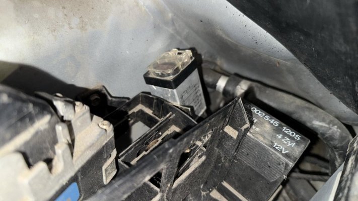

I searched high and low .I cant find its location .This is what it looks like .So look in the fuebox for it ..in the mean time i am still looking for the location ...this 200E is very rare engine to fiond information about ...it could take me some time to find its location but i will ..must post a letter so it will i take me ome time,,, but i will return to help you as soon as i can ..Trevor 1743675700237.png

On this model the fuel pump relay is incorporated into the K40 relay module under the hood on the passenger side inside the module box near the hood hinge. You need to open the module box and check the module with the fuses in the top of it.21 Feb 2010
Just had a good find the fuel pump relay is inside in the Kilner relay

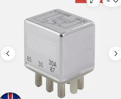

Ohh CAN you help me trasnleter little biz wrong, i must change yellow or red?

YELLOW relay is OVP .And RED one is the Kilner .The fuel pump relay is inside the RED relay marked in RED The Kilner relay is for other items also .
Thank you so much i go and BUy the new one a change after write for you ! Thank again
if you don't have power to the fuel pump, check to see if you have power to the fuel pump relay by connecting pin 30 to 87.
Hy where is this PIN?
Pull the relay off and turn it upside down. The pins are numbered.
Then use the irreplaceable special jumper tool pictured to make the connection where pin 30 and pin 87 would go
Do a short test as it will get hot.
