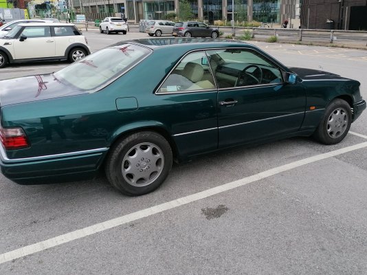

Here it is,looks good on exterior but is was a lot of work to do on it and it still is,I was thinking that maybe someone knows a mechanic near Sheffield that can fix my issue!I will think what to do in future with it.
Here it is the car,I was thinking that someone knows a mechanic near Sheffield to help me,because on Mercedes they told me something ireal,almost double the car price!

Paul it looks like a keeper and worth a bit of work . Sorry mate i am in Worcestershire . I would look at it for you if i was local keep asking .
