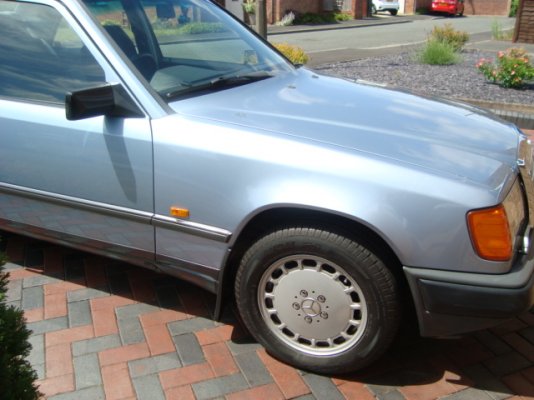

I think you will find that the new wings will be on special order from Germany .The new one i had was .But when i saw there was now way to fit the mud flap i returned it. And the other thing was no Mercedes star stamp . You will be ok,, you have the new model and the clading covers the bottom of the wing . . And then its getting them delivered without couriers damaging them. Lets us know how you get on .Ask the paint shop to give the back of the wings a good coat of spray on schults under body coating .And also waxyoil them onece you have when the car is at home. See when you fit the wings yourself you can treat the chassis after old wing is removed .This is what you will need to ask the garage thats doing the job for you to do .Point to look at for is the bumper location bolt bottom right drivers wing picture .Reason is i cought mine just in time i found surface rust in there so i had to go down to bear matal and then use a rust converter . Last picture is the passengers side before painting it .Had problem with paint match on driver side .Might get it done some dat soon we will see .It had to many metalic paarticals in the paint .
