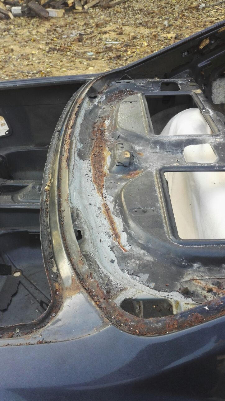

- Parcel shelf rot. Whilst the bodywork in general is exceptional (had had new wings quite recently), looking up from inside the boot shows a hole, and lots of rust. How much for a future-proof repair, and does this ever risk an MOT failure if left for a bit?

Didn't take enough pictures, but one before running, one whilst running, and the worst spot of rot looking up from the boot attached....
The rust doesn’t look awful, seen a lot worse.

Whilst the mileage is not as nice as you first though, it's not too bad (in terms of the cars value) but bear in mind these SEC's will only be worth decent money if they are standard and done properly. Doing away with the SLS or anything like that will hurt the value alot. MB use to supply replacement panels to fix those parcelshelves, I don't know if still available, rear screen out to do it properly.

Rear parcel shelf around £1,000.00. That was 15 years ago when we had ours done. I can recommend a body shop if not to far away which I have used for over 25 years. They looked after my 560. Vanleigh West Molesey 0208 783 1212 Ron or Leigh.
