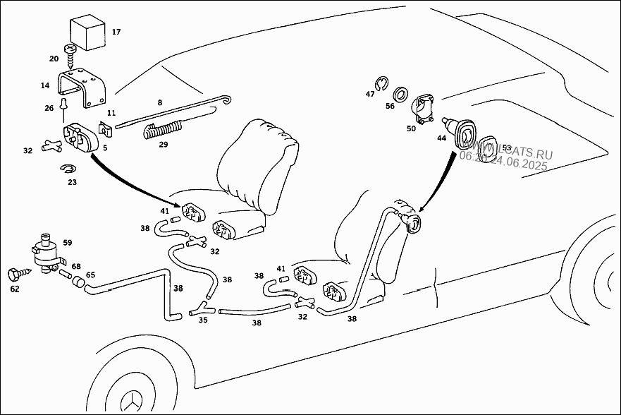

First question - if seats don't move back with doors open and engine off, and the side buttons on the seats don't so anything - what do we think? Most i've read talk about the opposite - loss of vacuum meaning you can't lock the seats...
Side buttons on the seats? The power seat controls are on the doors. If you're talking about this, then there's a seat module under the seats, if it's buggered, the seats won't move and neither will the steering wheel. Check of the floors got wet by lifting the carpet. You can adjust the seats by going in there with a small battery charger and sending power directly to the motors.
If you're talking about the lumbar support? then the bladders probably failed.
Sorry ... to be more clear , I mean my seats stay locked in position and will not fold forward to allow access to the rear. The electric seat movement is all fine ... I just can’t get into the back of the car !
the buttons on the side i believe are supposed to release the seats when the door is closed so you can fold toward ... neither side does that at the moment.

parts diagram shows the seat back lock actuating rod and RETURN SPRING!!!! In theory as vacuum is removed the seat back should unlock as vacuum is released- it sounds as if the spring has broken or the mechanism seized not realeasing the locking pin??

Excellent - thanks so much for this. Sounds a decent hypothsis - so I'll get a seat out at the weekend, and have a look.
Where is the diagram from? Is it possible to get pdf manuals for these...?
parts diagram from this website
Catalog MERCEDES
specifically
Catalog MERCEDES 560 SEC (126045)
and vacuum section
BACKREST LOCKING MECHANISM MERCEDES 560 SEC (126045)
