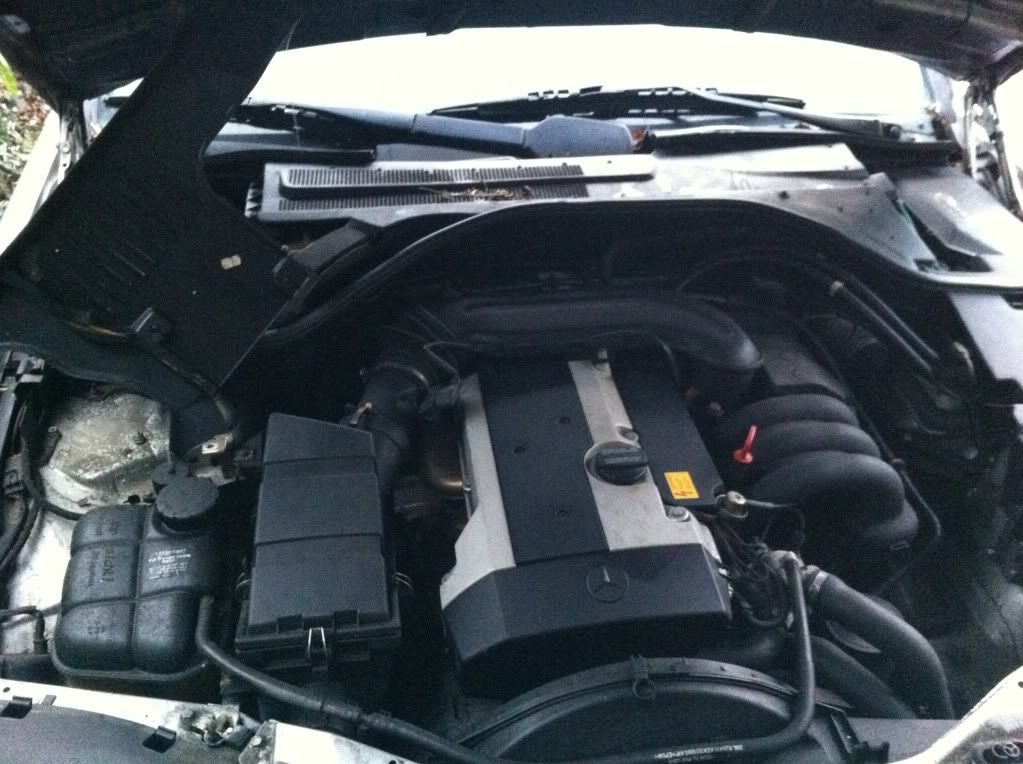

The only thing I can suggest is opening the " black box" if you have one??? That's the integrated power distribution bus module that contains many of the cars electrics normally located under the bonnet. It contains several control ECU type units. If you take off the lid check to see if any of the fuses are blown/corroded. There's a fuel pump unit in there somewhere. I assume you have the M104 straight six engine?

I lifted the black box area and there is nothing underneath, any other ideas where the relays may be?
There appears to be 2 wiring types for the w140 280 model one has the " black box"as I have said- where that is under the bonnet don't know? I thought that was it from the picture but obviously just a bit of cladding - possibly further back beside the brake servo then?? If there's only the older conventional type of fuse/relay box there then the fuel pump relay may be located in the boot. http://translate.google.co.uk/trans....ru/mercedes/F/#1/&sl=ru&tl=en&hl=en&ie=UTF-8
