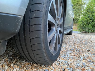

With original MB wheels and Dunlop tyres I’m surprised that the ride is so bad that you must sell it for that reason alone. What’s the date code on the tyres, and how much tread is left? Can you post a photo please?

Tyres are looking like about 50% worn, and yes on springs, not airmatic. Looking for a datecode on the tyres, the only one that makes sense says 2013 so yes, the tyres are definitely getting on a bit! I'm a stickler for originality though so would only want to drop down to 19" Grand Design alloys if I could find them.
