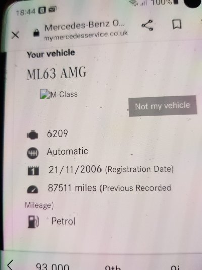

The information was from the online service booking system it will tell you the last service which is on the data base ie 87k if it has full MBSH it should be up to date ,if you go back on the mot history till the 87,000 miles to correspond with the service it is 2019 🙂
Here's the info
Here's the info
That doesn’t my necessarily mean it was serviced. That was the last time a Mercedes dealer or agent booked the car in but it could be for any kind of work including a free visual health check.
Owners of older cars would have taken the option to service their cars at independent garages or local indys. What is important is evidence of the service history and it's up keep. All receipts should retained in order in a folder for all thing's like oil, antifreeze, any parts renewed in it's life span etc
I would stay clear if the service history is thin or digitally thin, showing large gaps in service or worser the absense of service folder altogether.
For a used vehicle I would also check the mot history on gov.uk and see what it has failed. A car which has been highly maintained at a dealership, independently or DIY, will fly through an mot and likely to have a squeaky clean history and a fat service history book.
