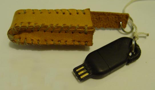

    If you car, by any chance, came with two (or even one) plastic "keys" that look like a slimline USB stick, one red, one black, then you can de-activate the alarm - the socket is inside the glove box, usually on the left side near the top.

    This is what I was talking about:
    [​IMG]
    It is on the page Abb referred to above:
    Bert Rowe's-A-class info. Information A160/Feb 2002 Scorpion Car Alarm System.
    The red key:
    [​IMG]
    And the black one:
    [​IMG]
    That page also got a link to Scorpion, although I'm not sure they still able to help / support the system.

    Your car will have factory fit, you won't have a scorpion aftermarket alarm and you won't have the black/red keys to switch it off.
