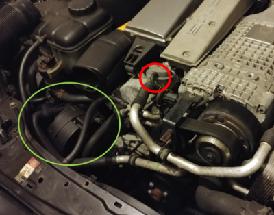

Well, Christmas is out of the way and I finally got some time to go through the tread and try some of the solutions.
I believe that the fault was caused by scale build up in the vacuum tubes (circled). I removed the tubes and scraped out a large chunk of white scale with a small pin from both tubes.
reset the MIL and all has been good ever since.

I got my pump here:
Secondary Air Pump For MERCEDES W203 CL203 S202 W463 W221 A0001405785 | eBay
I know it's flea bay but it does have a two year warranty so I was happy to buy it.
As for the relay, I went to a dealer as I didn't want to take any chances.
The pump itself is easy to replace (green circle)
Capture.PNG :
remove the engine cover
remove the air inlet hose to the air filters
unplug one push on hose from the side of the pump
unplug one electrical plug from the top of the pump
unscrew 3 retaining bolts from a bracket holding the pump in place and lift out
Put the new pump in place and plug everything back on - easy! (and the dealers wanted £500...)
Hope that helps
White scale?
Odd, that tube should hold vacuum only. I wonder what that scale could be.
White scale?
Best guess some kind of build up from condensation in the system?:confused: It's all I can think of tbh, but I might be totally wrong...
