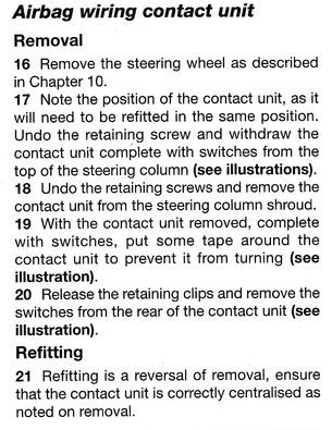

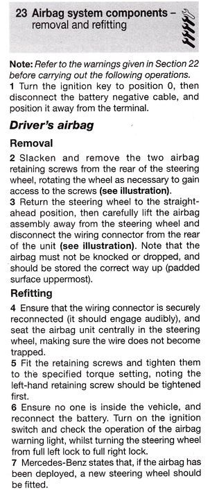

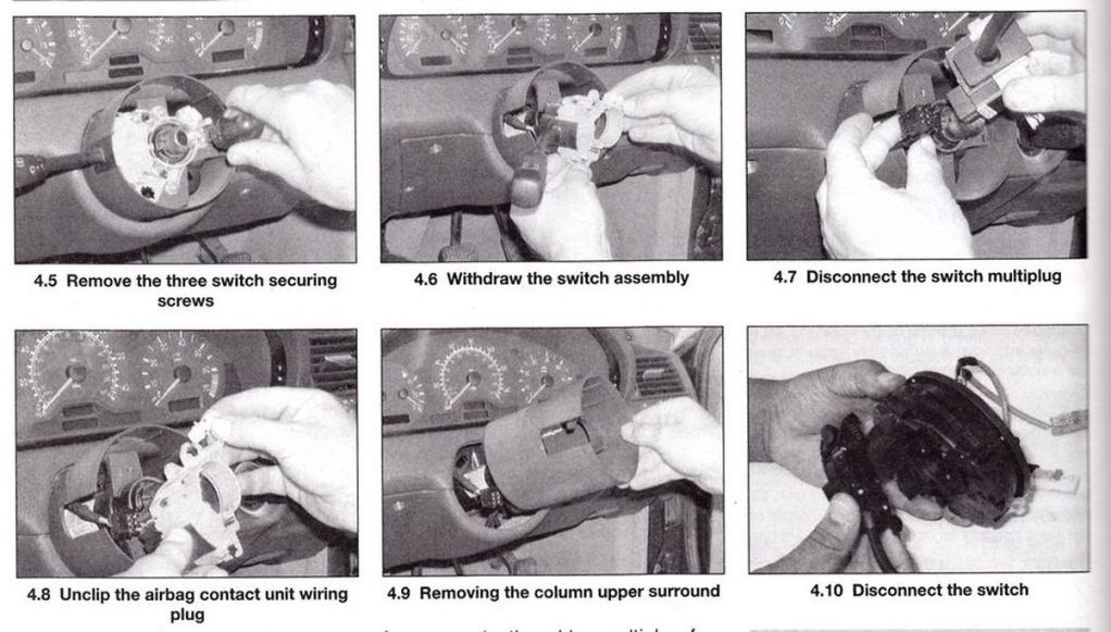

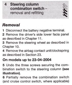

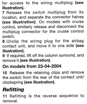

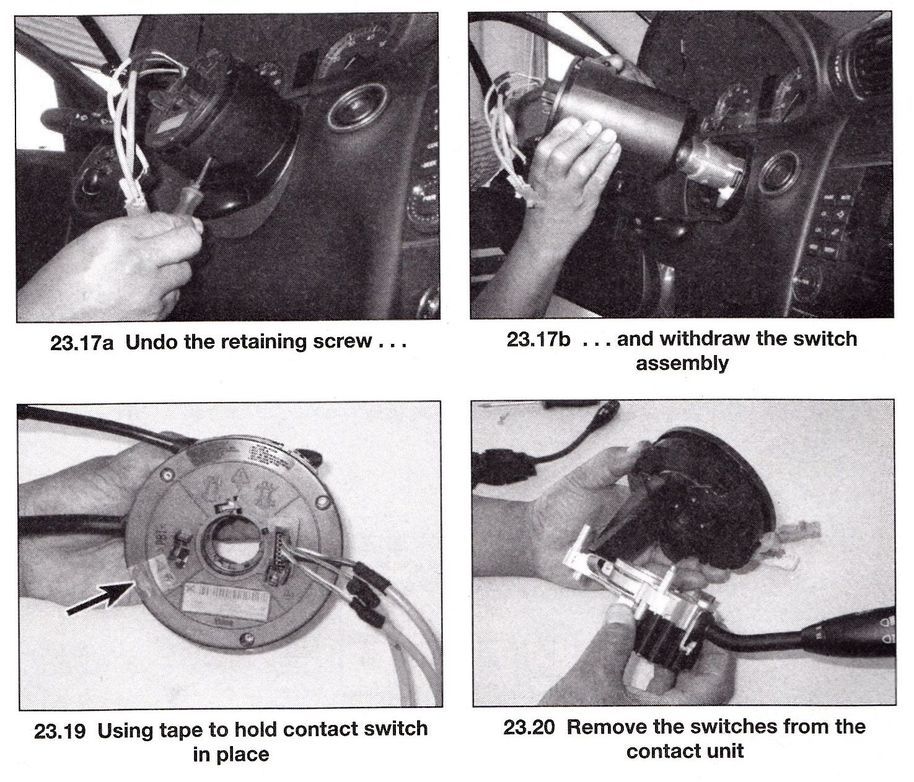

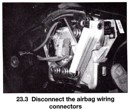

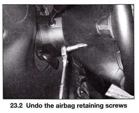

However if you feel confident, instructions to the best of my knowledge are below. I think I've incuded all the relevant information, but if there should be anything missing let me know. I noticed that it says to remove the lower facia, but I'm not sure if that needs to be done so haven't included that part. Steering wheel removal not included, as you say you have that info.
Please read through ALL information before starting the job as it is taken from different section of the manual.

1)Firstly with the keys in the ignition to turn the steering lock off I took out the two torx screws at the back. ( there is not much clearance so you have to have thin torx socket or allen key etc. Also pull the steering wheel out as necessary )
2)Then I turned the ignition off and carefully removed the air bag and the three connectors on the rear of it.
