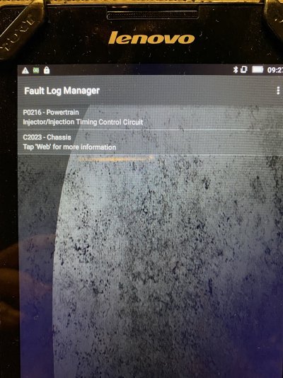

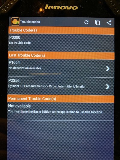

I get the below errors during first thing in the morning, when car is cold and experiencing the issue
P2356 Cylinder pressure sensor, cylinder 10 - circuit intermittent / erratic (I got this error in most of the APPs)
P0216 Injector / Injection timing control circuit + C2023 - Chassis (I got this error in only on APP)
I get the below error when car is warm and not showing any issue to start or drive (it shows only the below error)
P1664 powertrain
I will prob bring it to another garage but was wondering if there is any advice on these errors ? Anything / part that can be replaced that may help?
For everything that I read so far (quite a lot) it points to be a problem with 0 rings (getting air in the fuel lines when engine is cooling down) and Crankshaft Position Sensor..
Please any help is appreciated
