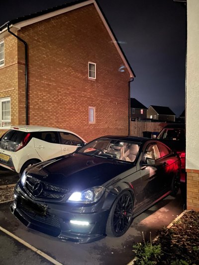

thank you for the replies. @alexanderfoti I believe it to be a face lift model, I will attach a photo if that helps. @Petrol Pete yes I know it’s a bit drastic, but I was told that this was be the quickest and hassle free solution. But when I got to the garage of choice he advised me to investigate further as the transmission doesn’t seem to bad on the car. It’s currently at 62k miles, it’s a 7 speed automatic transmission.

Mean looking motor 👍🏻
I hope it’s sorted with the minimum of fuss 🤞🏻
