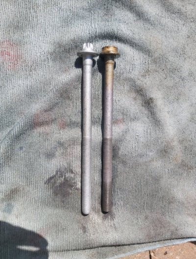

There were 3 different types of bolts used for the M156 line up. I have no idea why they used different ones?
The first ones were of T55 head, I think up to years 2008/9, which are good but you do need to make sure you do regular changes in antifreeze as it contains inhibitors to prevent corrosion.
They then went over to the T60, they are the most dangerous bolts used, it had very little material on the head. Those were found from around 2009 up to 2011/12. They then went with the E14 bolts onwards which have a lot more material on the head, less chance of breaking off.

Great info thanks 👍 I never realised there were 3 types. I'm looking at a 2008... Hadn't realised they were potentially less of an issue than 2009-11 cars!
I've never heard of any head bolts issues in UK but across the pond in hot countries, maybe they use tap water or something? Those bolts had corrosion attacking the underside of the head bolts weakening it. The T60 were the worst ones they used 😯
And those that aren't in a garage and haven't been looked at are more than likely on original headbolts. Big hype, scare mongers.
Other model AMG have as more hyped faults like the early m157 weak drive chain and the wiring harness oil contamination issue.
I would say on the m156 the cam adjusters will show signs of troubles way before the headbolts. Like has been said, two year coolant renewals with distilled water is one preventive avenue.
