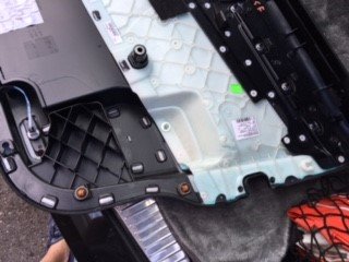

Pass Door Release damaged 2.jpgDoor Card 1.jpgDoor Card 2.jpgDoor Card 4.jpg
Have popped some pics in showing the break in the cable-retention part of the handle.
The three shots of the door card highlight the need for spare clips - 5 on the 9 needed replacing as they had either broken off in the door frame (brittle), were missing the rubber washer that sits between the door card & door frame or, just generally the worse for wear.
