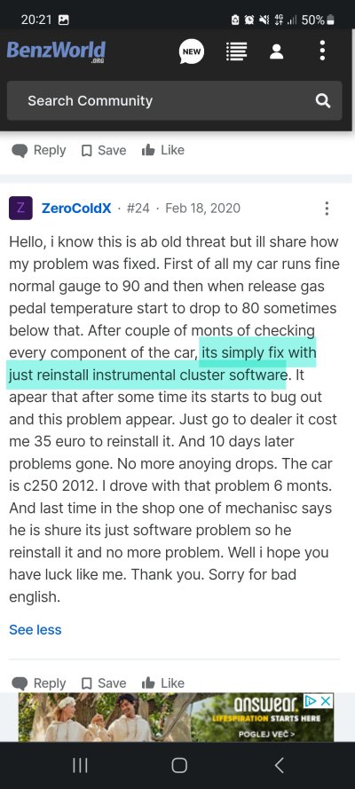

It could be some software upadate need it. I dont know how to come with this to the dealer. They dont know nothing anywhere..they have testers but dont have konwledge
