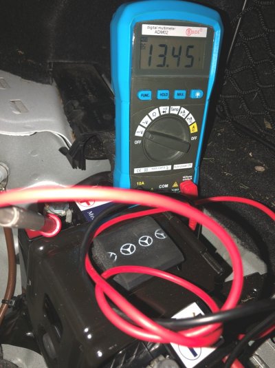

This will show you where the battery is and you just need access to the terminals to charge it like you would imagine.
I wired in a couple of wires on to my aux battery so I can charge it through the fuse hatch at the rear.
If your aux battery has never been charged, it may take a while to fully charge but it's a small battery so we are talking an hour or two at a guess.
My aux battery gets a charge once every quarter now and takes a few moments to fully charge now (and also it was new a year ago).
I have done the same by fitting a set of CTEK quick connectors to my Aux Battery and giving it an all-day charge once a month while it is parked in the indoor parking lot at work.
