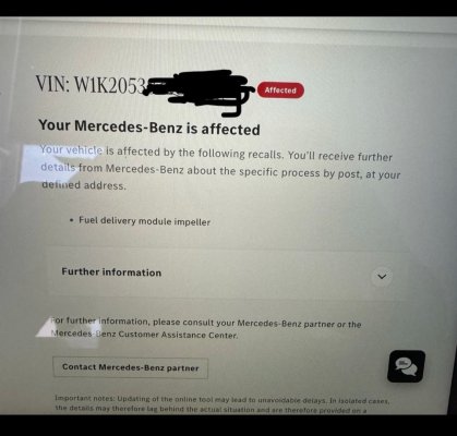

I have a 2021 model and was experiencing the same thing, nothing happens when I revved it at standstill, this changed after I had a software update during service.
It brought the pops and bangs back, and it does so consistently.
When was the last time you had an engine software? The attached was also a recall that was dealt with at the same time
Perfect
Well my engine light flashes and the car feels like it misfires time to time
So tomorrow I have an appointment
Will get it looked into along with the pops and bang see what they say!
Thank you so much for letting me know
