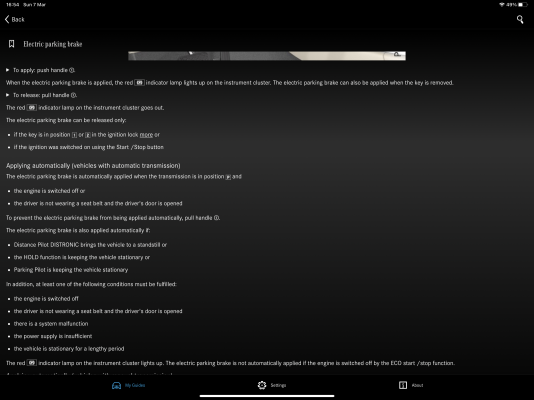

Just a quick question really regarding the parking brake on a w205.
I understand they're electronic but mine doesn't appear to engage when I press Park on the stalk which is what I expect it to do
Is it a manual electronic parking brake? I.e. do I have to engage it everytime I'm parked up
No it should come on when you open the drivers door. For example if you are in d and open the door the vehicle will select park and apply the parking brake.

The switch for it slightly lower down, below the light switch, close to your right knee.
Gearbox park position and parking brake are two different things. Gearbox park is a pawl within the gearbox. Parking brake is incorporated into the rear wheel brake calipers.
See this is what Im struggling with.
So when I park my car, I press the button on the stalk to put the car into park. I turn the car off, I take the seatbelt off. And then I open the door. At no point does the red PARK logo light up in the instrument cluster
If I park my car, press the button on the stalk to put the car into park, take the seatbelt off and then press the silver metal P button at knee level the red symbol lights up.
So Im not particularly sure what Im supposed to be doing!

Not sure what year your car is, but my first 205 (early 2014) operated a bit differently from what my present one does and was more like what yours seems to be doing. I think the change came during 2015 or thereabouts. This might help to explain your problem.

Not sure what the confusion is here. Put your car in park, then press the parking brake button, then switch off - job done?! As others have said, there are certain factors that would apply the brake automatically, but frankly I wouldn't rely on them - I like to ensure everything is secured before getting out....
I never use it...just put it in park and that's it....when I pull in my drive and switch the stalk from D to R...I then press the parking brake button to release it as it comes on automatically...if I don't press it and just reverse into my garage you can feel a jerk as it automatically releases...I release it manually to prevent this...
If I understand this correctly it is only called auto parking brake because it comes off automatically. It’s the same as the one in my sq5. Stays on until you put the car in drive and pull away. You still have to engage it when you stop or get out.

This might have something to do with it. Its a 64 plate, December 2014 car.

See this is different to mine. Mine doesnt come on at all, even if the door is opened or the car is parked. In other words, I never have to release it as it never engages unless I do it myself.
That makes more sense! So its an auto-off handbrake, not an automatic hand-brake as in other cars. Both Lexus in the family just do it automatically on and off. My previous Jag XE did the same so was a bit confused with it

The confusion with the 205 C Class arises because there was a change in its mode of operation early on; my 67 plate car has a number of upgrades, spec for spec, from my 64 plate and one of the changes is that the parking brake operates differently. The early ones didn't interlock with the doors as the newer ones do.
