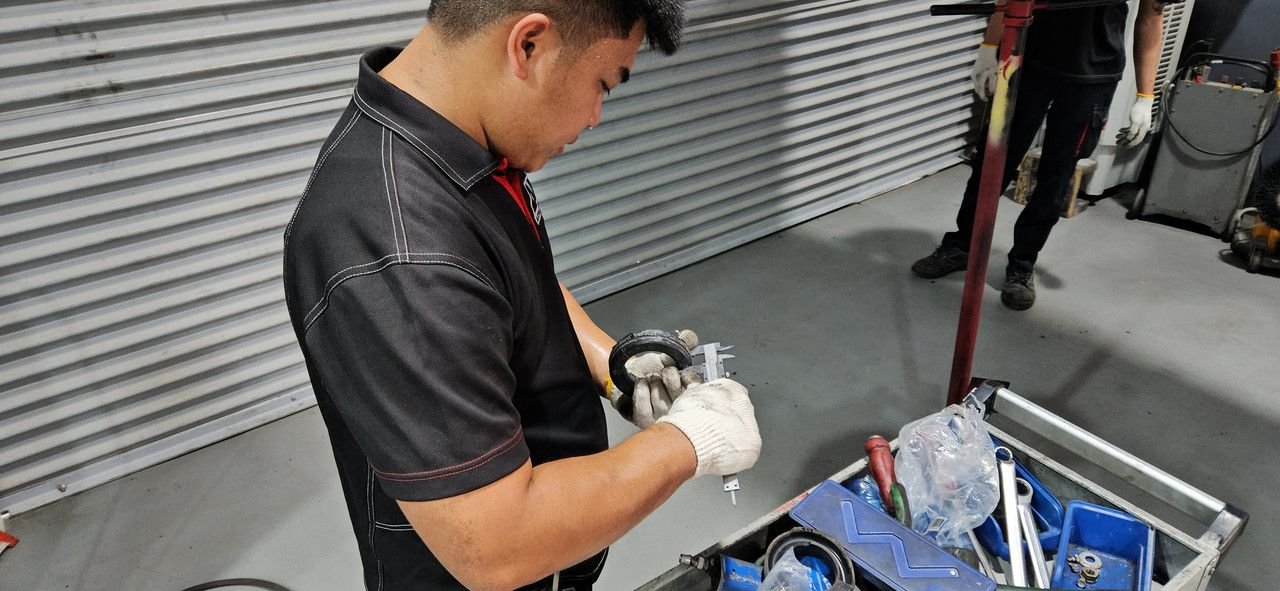

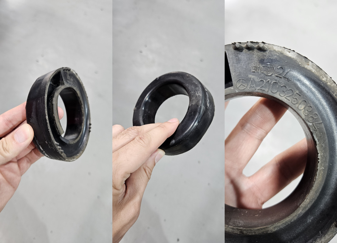

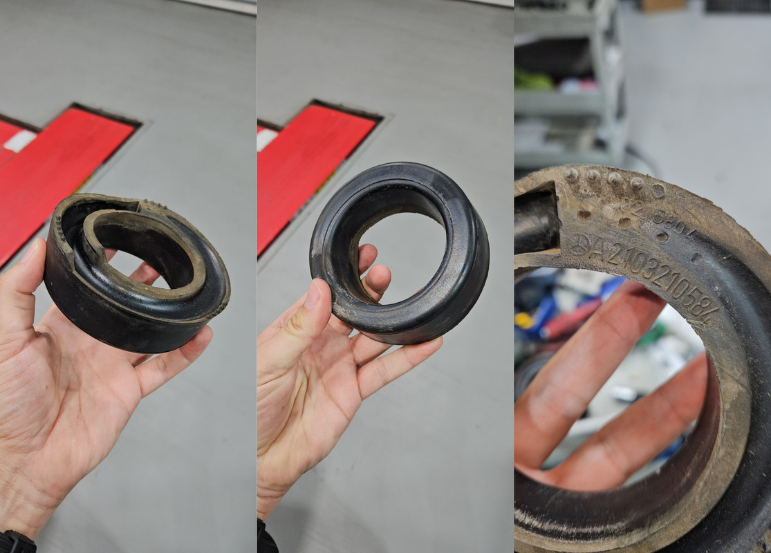

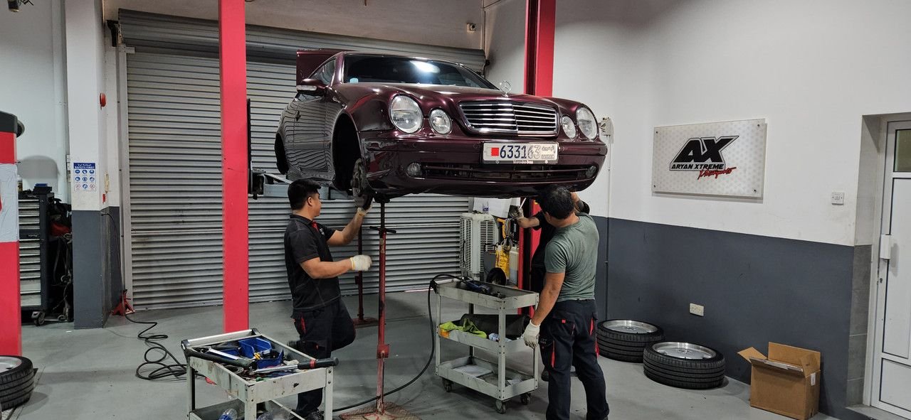

I went ahead and ordered #1 (5mm) and #2 (9mm) pads for the front, and number #1 (5mm) pads for the rear.
Anyways, in conclusion. If you own a Euro CLK55, don't waste your money on H&R springs, just replace the pads.
And it's done!
