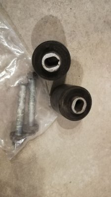

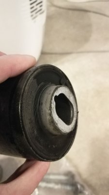

Problem resolved.
Replaced the bushings with the new part#. Central section of the bushing is totally different.
Also the rubber "caps" were not installed originally on mine.
Minor cracks, visible only when cleaned a bit. I would have never thought that they cause all that trouble :)
All noises gone. Big THANKS @markjay .
