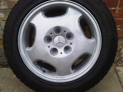

I have refurbed my own wheels on my W210 and they came out well. Its just a time consuming job, taking on average 3 days per wheel. Luckily I have a spare set of wheels for my W210 so I had the luxury of being able to take my time over it. Don't waste your time trying to do it with the tyres on as you'll get a very poor finish if you have the patience you can get a very acceptable finish doing it yourself for a fraction of the cost. Mine were badly corroded, pitted and scuffed and ended up looking like this:
Hi,
The result looks quite impressive !

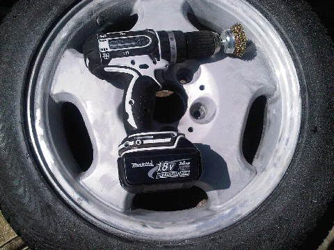

I started by stripping the wheel of lacquer by using nitromoors paint stripper. This works brilliantly to get the clearcoat pretty much all off. I gave it a couple of good coats of stripper leaving the last one on for an hour, but dont let it dry as it can eat in and score the metal. I then used a soft wire brush attached to my new Makita electric drill which made very short work of the remaining corrosion and any last bits of lacquer etc.
The picture shows the tyre still on but at this point I popped the wheels I had down to my local fitter and had the tyres removed, I would recommend you do this before you start stripping etc though.
