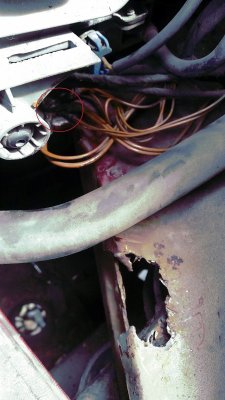

Indeedy bob6600 it was the earth connection behind the light, as soon as touched it, it broke of, so connected it for the time being to a holder for an engine cooling hose, as I am not very mobile at the moment.
Dipped Xenon beam light works again, and I do not get any warning lights on when accelerating.

Through the power of Google this post saved me untold hours of fruitless diagnosis.
A quick wiggle of the earth connection and it came off. 1 hour later with a shiny new earth point all the very weird symptoms were completely gone. Even a few more pixels in the dashboard temperature display reappeared!
Offside headlight working. BAS working. ABS working. Electrical System failure notice, gone. Engine cutting very briefly every 40 seconds, cured.
Result.
Sometimes the simplest and oldest solutions are those that work best.....
Excellent advice - same symptoms, same cause. My earthing stud (under the air cleaner box) had completely rusted off the member. There's a similar size hole under the headlight unit which the wires will reach easily so I cleaned off the paint to get a good contact and re-used the earthing stud and nut.
