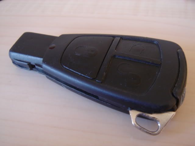

Hi folks have a friend with a late pre facelift W210, which is giving some troubles with the key. It wont lock or unlock the car through the buttons. Have done the simple infa red test through a camera and it does show the white light so I would think theres nothing mechanically wrong. Im thinking its lost its memory maybe and needs re-syncing, does anyone know how this is done or have any other tips or advice ?
This is the key by the way:
Thanks in advance

Or, check the bottom of the key itself, has the red plastic lense become damaged?

The key at the bottom where the red bit is looks fine, no cracks just some minor scratches in that plastic but nothing serious that I would think could stop its function.
