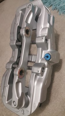

Does anyone have any pictures of the mounting points on the front calipers from the E55 AMG? Also, are the calipers any different to the w211 E63 calipers?
Thanks.
Thanks Minty. Do they mount on both sides? Could you measure the distance between the holes if you don't mind please?
To answer above, looking at a possible project to see if they will fit another car.

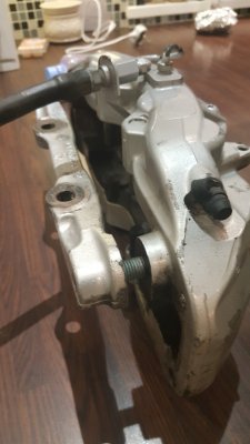

only got a tape measure here so possibly not accurate, the distance between bolt centres looks to be 112mm , i have taken a few more pictures , there is a separate mounting bolted to the calipers , th a.jpg e pics might explain better.
Thanks Minty, really appreciate your time. Now to speak to some fabricators!
Awesome, thank you. Do you know if you can get the brackets separately?
i dont know, the new calipers came with them on, the pictures i have posted the new caliper is for an E55 AMG , the old caliper is from an sl55 amg , the main caliper body is slightly different but the mounting hole position and size is the same. if you need any accurate measurements let me know.
