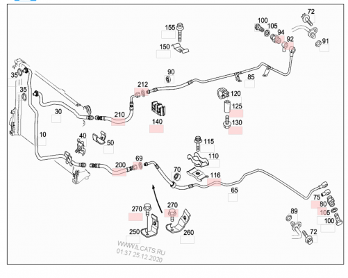

Id also highly recommend changing the both lower ATF pipes OE only as these corrode and can be damaged or leak on refitting.

Ah ok thanks for the advice. With regards to the ATF Cooling lines are you referring to #10 & #30 in the diagram?
