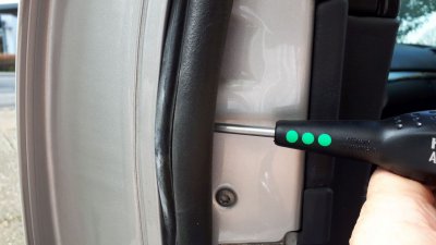

First job is to peel back the door rubber adjacent to where the door handle is on the outside and locate a small hole about 8mm diam.
Insert T20 torx screwdriver and undo screw a few turns whilst holding the small part of the handle outside. Keep wiggling it until it feels loose. Don't undo the screw too far and lose it in the bottom of the door. I found about 6 turns enough.
This is the piece of door handle that is removed first and enables the rest of the handle to come out.

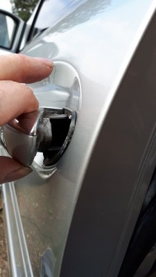

To remove the main part of the handle, carefully pull it up and towards the door jamb. IE, to the right on a n/s door. The part nearest the door jamb will come out first and you then have to twist the handle to free it from the door itself.

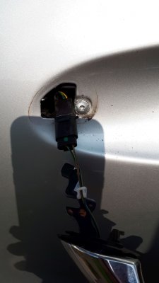

On a keyless go handle, the plug is back inside the door and you have to manouever the plug out through the handle opening with either long nose pliers or a small flat bladed screwdriver.
Be careful not to break any wires.
There is a clip on the back of the plug which is raised to seperate the two parts. Dont lose the female end back inside the door.
That is the hard part. Refitting the handle is a reversal starting with fitting the black plastic gasket over the plug on the handle and the one on the other end as well. Reconnect the plug and push it well inside the apeture where it wont be fouled by the handle.

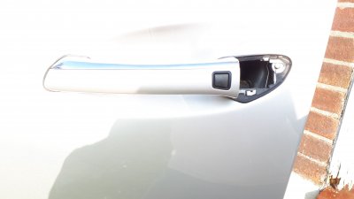

Slide the plug end of the handle back in along with the other end ensuring the gaskets stay in place.
I had to reposition the handle a couple of times to get it right.
The handle should be flush against the door as below and just waiting for the small part of the handle to be secured with the screw. You can see the screw that holds this inplace at the top right of the photo

All I would add is that for the rear door handles you need a much longer torx driver, around 300mm shaft or more from memory due to the shape of the door and the access needed. Unfortunately it has to be a slim torx driver (no bits fitted into extensions etc) as the access hole is tiny as you have seen.
I had to buy one specifically for my silver ‘55 when I did those, like this:
WERA TOOLS EXTRA LONG BLADED 300mm LONG TORX STAR T20 SCREWDRIVER 367 HF | eBay

If its a rear one, as Will says above, you need a long T25 torx screwdriver to release the handle. The front one only needs a short one.
