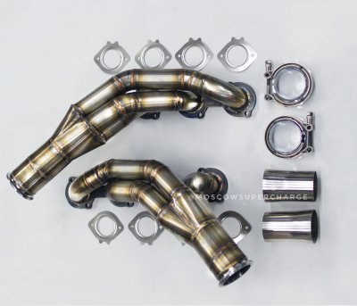

MSC - Moscow Supercharge.

These are 750 usd as they are in a sale untill the 15th of Jan from MSC

Sorry they are 750GBP not USD

The MSC ones look like mids to?
Do they fit well etc? That’s a good price! Have you a link to where they are on sale in case I do a buy!? Lol.
Do the MSC ones fit a RHD with no major bashing?
