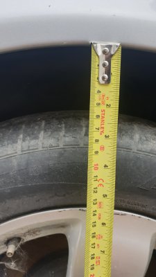

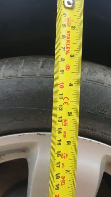

I took some pictures of the front vs the back. As i recall, they sat at similar levels previously..
That looks too high.
I would guess that's a W211 Avant Garde from the alloys. My recollection is that that this sat 10 to 15mm lower than the Elegance and Classic variants.
So my first *guess* would be that the car had Elegance / Classic springs fitted instead of Avant Gard springs. After the new springs were fitted it could sit a little bit higher for a while as they settled so whoever fitted the springs might assume that if they didn't sit quite right then that would be temporary.
